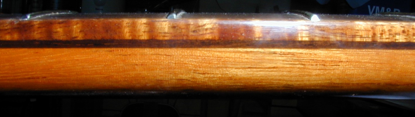

You might want to route in a rabbet to the tapered fingerboard and set the binding in that. It gives you a nice, thin line of exposed fingerboard wood along each side of the fingerboard and sort of a delineation line between the neck shaft and the binding.
See the following photo for an example of koa on an ebony fingerboard:
